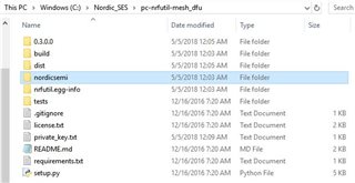

SDK 15 and Mesh 2.0 Generate a DFU file with nrfutil - ValueError
We used nRF5_SDK_15.0.0_a53641a and nrf5_SDK_for_Mesh_v2.0.0_src.
We are following DFU quick start guide http://infocenter.nordicsemi.com/index.jsp?topic=%2Fcom.nordic.infocenter.meshsdk.v0.10.0%2Findex.html
For nRF52:
mesh-sdk$ nrfutil dfu genpkg --application bin/blinky/blinky_nrf52832_xxAA_s132_5.0.0.hex \
--company-id 0x00000089 \
--application-id 1 \
--application-version 2 \
--key-file private_key.txt \
--sd-req 0x009D \
--mesh dfu_test.zip
We used "--company-id 0x00000089 \" to match Step 2 public key:
"bootloader_config": {
"bootloader_id": 1,
"bootloader_version": 1,
"company_id": 89,
"application_id": 1,
"application_version": 1,
"public_key": "ed09a58df6db5cd15b8637304f31d31f4042492ed7c7e4839fbe903f260a2ba1a855e92b72885825481ad56282bcf549ad7455ec46f000f0f62d97eeec883ba6"
The hex we used is C:\Nordic\nRF5_SDK_15.0.0_a53641a\mesh_sdk\bin\blinky\blinky_nrf52832_xxAA_s132_5.0.0.hexblinky_nrf52832_xxAA_s132_5.0.0.hex
We got ValueError, please see attached screen shot.
Please advise.  Thanks
