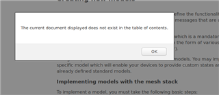

Hi the link does not seem to be working. It leads to a page with this notification.
I have updated the link :)
