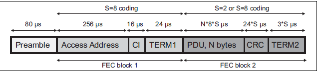

I'm doing some experimental evaluation of BLE Long Range. I use the ble_app_att_mtu_throughput example with parameters:
  • ATT MTU: 247 bytes
  • Data length extension: 251 bytes
  • Connection interval: 20 ms
  • Connection length extension: on
  • Preferred PHY: Coded
Using these parameters, I get an experimental throughput of 40.08 kbps. I also want to theoretically validate this, in the same way I did for 1Mbps and 2 Mbps PHY (https://devzone.nordicsemi.com/f/nordic-q-a/29269/theoretical-throughput-doesn-t-match-experiments-done-via-ble_app_att_mtu_throughput-example). But now I need to use the packet format of a Coded Phy packet, given below:
Using this information, I calculate:
  • Tx-Time (full packet) = 80 µs + 256 µs + 16 µs + 24 µs + 257 * 8 * 8 µs + 24 * 8 µs + 3 * 8 µs = 17040 µs
  • Rx-Time (empty packet) = 80 µs + 256 µs + 16 µs + 24 µs + 2 * 8 * 8 µs + 24 * 8 µs + 3 * 8 µs = 720 µs
  • IFS = 150 µs
=> Theoretical send-time = 17040 µs + 720 µs + 150 µs * 2 = 18060 µs
But through previous questions (https://devzone.nordicsemi.com/f/nordic-q-a/29269/theoretical-throughput-doesn-t-match-experiments-done-via-ble_app_att_mtu_throughput-example and https://devzone.nordicsemi.com/f/nordic-q-a/28682/ble_app_att_mtu_throughput-throughput-calculation-packets-per-interval-data-length-extension) I know that the SoftDevice will first check if a full TX and RX can still be done before a next real packet exchange is scheduled. The timing for this is Tx-time (full packet) + Rx-time (full packet) + 150 µs * 2 = 2* 17040 µs + 300 µs = 34380 µs. However, this is already more than the full 20 ms connection interval... So it doesn't fit in there even once...
So in short, I'm a bit at a loss how to calculate the theoretical throughput for Long Range BLE...
Any help would be greatly appreciated. Thank you in advance.
Mathias
    I'm not sure if I understand your reasoning at the end. Shouldn't it be
    Tx-time + Rx-time + (IFS * 2)
    and not
    (Tx-time + Rx-time + IFS) * 2
  • You mean "Tx-time (full packet) + Rx-time (full packet) + 150 µs * 2 = 2* 17040 µs + 300 µs = 34380 µs. "?  I calculated that the time for a full packet is 17040 µs. Because of the Softdevice checking if a full Tx and Rx can still be done before the real transmission is scheduled, the time to check is 2 * a full packet + 2 * IFS = 2 * 17040 µs + 2 * 150 µs. Or at least, that's how I understand it right now.

    I have discussed a bit back and forth with the Softdevice team, and it turns out that our Coded phy solution doesn't actually support long packets at all. In other words, it is packets with maximum 27 bytes L2CAP + 2 bytes LL. So, we don’t send or receive long packets which explains why you see packets distributed over more than one connection event. It is strange though, that you are seeing 34 ms events. Maybe it is a result of using radio notifications.
    Anyway, to get any further in this, we will need your code so that we can use a sniffer and see what actually goes on in the air.
