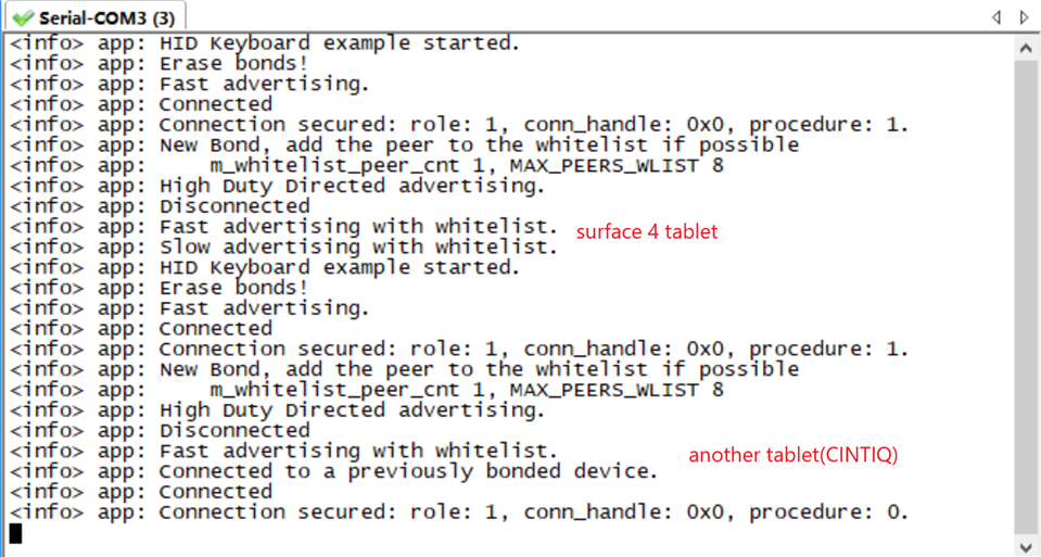

I use nrf52832 board by fast advertising to connect the central(surface 4 Tablet).Then the board go to sleep.when I push the button the board use direct advertising to connect the central again,but it dont connect. I use the peer manager to get the central address,when the BLE_ADV_EVT_PEER_ADDR_REQUEST event of direct advertising happens.
SDK 14.2  Softdevice 132 .Can you give me some suggestions about direct advertising to connect previous central successfully.

    <info> app: New Bond, add the peer to the whitelist if possible
    <info> app:     m_whitelist_peer_cnt 1, MAX_PEERS_WLIST 8
    <info> app: Directed advertising.
    <info> app: Disconnected
    <info> app: Fast advertising with whitelist.
    <info> app: Connected to a previously bonded device.
    <info> app: Connection secured: role: 1, conn_handle: 0x0, procedure: 0.
    <warning> nrf_sdh_ble: RAM starts at 0x200020E0, can be adjusted to 0x20001F50.
    <warning> nrf_sdh_ble: RAM size can be adjusted to 0xE0B0.
    <info> app: HID Keyboard example started.
    <info> app: Erase bonds!
    <info> app: Fast advertising.
    <info> app: Connection secured: role: 1, conn_handle: 0x0, procedure: 1.
    <info> app: Disconnected <info> app: Fast advertising with whitelist.
    <info> app: Slow advertising with whitelist.

    I just see the central don't send info of CONNECT_REQ in direct adv.

    The sniffer log ,you can ignore the beginning content of direct adv.The following is fast adv connect with the central.When they connected, I test 2~3 direct adv.so,that's the sniffer log's sequence.
    the nRF sniffer log with nRF52SDKv14.2 with CINTIQ (or another) don't have the green color mark when connect via fast adv.I don't know why.Maybe ,I can repeat it again. But we can see when they connect with fast adv, the central send CONNECT_REQ in the line of 1294 of sniffer log named nrf52_CINTIQ.pcapng.

  • SDKv15''s  example of ble_app_hids_keyboard has the same  phenomenon with the SDKv14.2.
