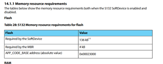

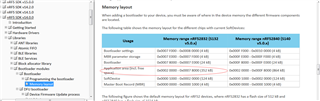

we want to confirm the application start address of s132 v5.0
this picture is    from infocenter.nordicsemi.com/index.jsp
and this picture is from   《S132_SDS_v5.0.pdf》
 in first  picture  the application base  is  0x00020000 , in second picture the application base is 0x00023000
