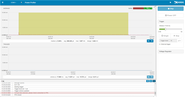

I have purchased 2 nrf52 development kits with 2 power profiler kits to go with them. I am trying to measure the current / power consumption of a lithium ion battery CR2477 in a small test circuit.

After I've connected the DK to the computer (PC) it asks for a firmware update, I agree and continue. I select the COM port to use and select start.
It seems to work from here, and we'll get to that in a bit. But after pressing start, the system disconnects or drops into an error for no apparent reason. Please see image below:
I'm not sure if the quality is good enough, however the text under the red highlight it says: "Corrupt data detected, please check connection to PPK"

  • After reading your comments, it is quite apparent that the software does not find the correct PPK firmware, and assumes you have an old version/ installed or is erased. To me, it seems like it is programming the DK.
    OR, something is being messed up from soldering bridges on the DK. Being that you are using an external DUT, no bridges on the DK should be soldered. External supply is only connected to the PPK. The only preperation for the DK is the current measurement bridge that should be cut.
    Have you ever had it working before? For instance, does it work in the standard configuration, i.e with the ppk connected to the dk, nothing external, USB connection to the DK?
    You should also try to do an erase before launching the application, which will ask you to flash. Verify that it is the PPK that is erased, by observing your DK acting normal (just flash it with e.g. a blinky example and watch LED's still flashing after erase).
    If you do an erase, then flash the firmware yourself (find the firmware at C:\Users\<user>\.nrfconnect-apps\node_modules\pc-nrfconnect-ppk\firmware\) and the PPK app still reports the need for flashing a new firmware, then we know for sure something is wrong with the connection/flashing/reading.
    Also, is it so that you are acquiring average (top chart) samples without any problem, and it fails after starting trigger? If so, there is something really wrong with the SEGGER interface. I have seen this before if trying to push more than we can out of the ppk, overflowing buffers on the on-board debugger. This can also occur on the PC-side if using an old version of the SEGGER software/libraries.
    I might have more input, but it would be nice if you test these things first. And as a final note, do _not_ use trigger if you are after correct power profiling. It will make the measured average less accurate due to lost average data, as stated in the user guide.

    I will get to testing all these suggestions, will get back to you with results as soon as I get them. But to answer your SEGGER question, As soon as the ppk is connected and the COM port selected, I do press start and it does acquire something. Not 100% sure the acquired data is from my DUT, but it gets something that repeats every 4 seconds. After a minute or two, the log displays the "corrupt data detected" message and stops the acquisition. Buffer doesn't buffer anything unless I select a window to view, and the trigger doesn't seem to properly adjust (please see image attached above, where external trigger is set to 15 uA and the log displays 1 uA.) However I am using the newest version of NRF Connect.
