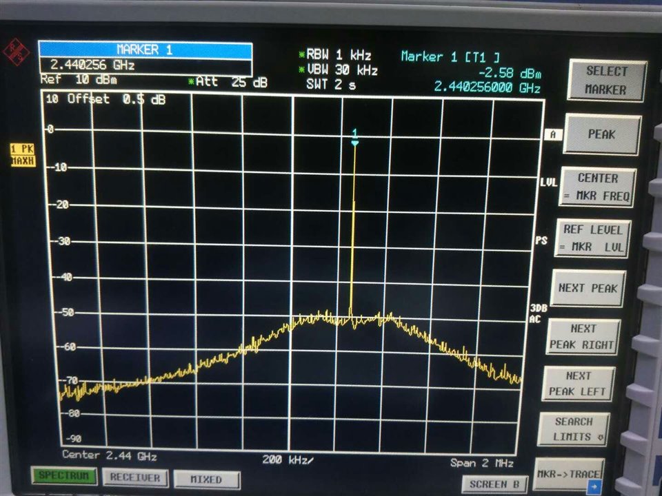

Huge BLE carrier frequency drift
I have huge BLE carrier frequency drift, which cannot pass FCC requirement.
The drift is 256kHz which seems not normal.
I'm using 32MHz 10ppm xtal so drift should be few tens of kHz AFAIK.
I got images from the test lab as below.
Any comment will be appreciated.
