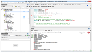

  • Now I  combine the light switch client demo in mesh sdk1.0.1 with peripheral uart demo of sdk14.2.  I added the mesh sdk in nRF5_SDK_14.2.0_17b948a\components\mesh and removed the sdk14.2 from  F:\nrf5_SDK_for_Mesh_v1.0.1_src\external ,also I added & changed the path of these files. But I got some errors after that as follows:
    Building ‘uart_pca10040’ from solution ‘uart_pca10040’ in configuration ‘Debug’
    Compiling ‘main.c’
    nrf_mesh_sdk.h
    main.c
    #error "Unknown target softdevice version"
    Compiling ‘nrf_mesh_sdk.c’
    nrf_mesh_sdk.h
    nrf_mesh_sdk.c
    implicit declaration of function 'mesh_softdevice_setup' [-Wimplicit-function-declaration]
    'lfc_cfg' undeclared (first use in this function)
    each undeclared identifier is reported only once for each function it appears in
    unknown field 'lfclksrc' specified in initializer
    Compiling ‘nrf_mesh_weak.c’
    nrf_mesh_prov_types.h
    nrf_mesh_prov.h
    nrf_mesh_weak.c
    #error "At least NRF51, NRF52_SERIES or HOST must be defined."
    nrf_mesh_assert.h
    list.h
    nrf_mesh_prov_bearer.h
    nrf_mesh_prov_events.h
    nrf_mesh_prov.h
    nrf_mesh_weak.c
    nrf_mesh_weak.c
    dfu_types_internal.h: No such file or directory
    Compiling ‘provisioner.c’
    provisioner.h
    provisioner.c
    nrf_mesh_assert.h
    list.h
    provisioner.h
    provisioner.c
    utils.h
    packet.h
    broadcast.h
    advertiser.h
    nrf_mesh_prov_bearer_adv.h
    provisioner.c
    #elif with no expression
    #error "Unsupported hardware platform"
    packet.h
    broadcast.h
    advertiser.h
    provisioner.c
    operator '||' has no right operand
    Build failed
    Coule you help me to solve the problem?
