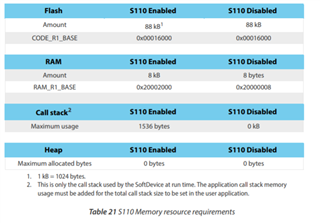

I see that APP Layer RAM usage is: 2.4KB, which seems to be a lot ...
Now I cant find the way to get RAM usage from s110_nrf51822_7.3.0_softdevice.hex  (as I dont have the .out) in order to find out it it reaches 4KB.
If I run:
arm-none-eabi-size ~/s110_nrf51822_7.3.0/s110_nrf51822_7.3.0_softdevice.hex
   text       data        bss        dec        hex    filename
      0      84596          0      84596      14a74    ...nrf51_sdk_v6_1_0_b2ec2e6/s110_nrf51822_7.3.0_softdevice.hex
It seems that the data size is wrong calculated, right?
Any help would be be appreciated
