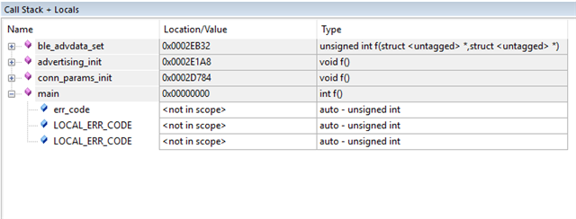

0> <error> app: ERROR 7 [NRF_ERROR_INVALID_PARAM] at ..\..\..\..\..\..\components\ble\ble_advertising\ble_advertising.c:287
after reset, the error always come up
0> <info> ant_hrm: ANT HRM channel 0 init
0> <info> app: pm_whitelist_get returns 1 addr in whitelist and 1 irk whitelist
This erorr was ERROR 12801 [Unknown error code] from ble_advertising_error_handler before i put APP_ERROR_CHECK to advertising.c.
As far as I know from other posts, 12801 stands for "BLE_ERROR_GAP_DISCOVERABLE_WITH_WHITELIST"
which is Use of Whitelist not permitted with discoverable.
It seems that the problem occur because the device is trying to advertise with whitelist.
I did set BLE_GAP_ADV_FLAGS_LE_ONLY_LIMITED_DISC_MODE in advertising_init() but the example code also do so which seems like it will switch automatically the flag to BLE_GAP_ADV_FLAG_BR_EDR_NOT_SUPPORTED before switching to advertising with whitelist from the code below, am i correct?

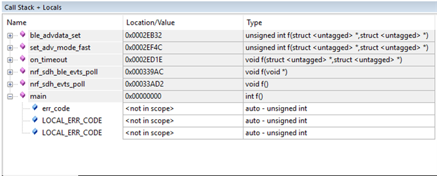

static ret_code_t set_adv_mode_fast(ble_advertising_t * const p_advertising,
                                    ble_gap_adv_params_t    * p_adv_params)
    ret_code_t ret;
    p_adv_params->interval = p_advertising->adv_modes_config.ble_adv_fast_interval;
    p_adv_params->timeout  = p_advertising->adv_modes_config.ble_adv_fast_timeout;
    if ((p_advertising->adv_modes_config.ble_adv_whitelist_enabled) &&
        (!p_advertising->whitelist_temporarily_disabled) &&
        (whitelist_has_entries(p_advertising)))
        #if (NRF_SD_BLE_API_VERSION <= 2)
            p_adv_params->p_whitelist = &m_whitelist;
        p_adv_params->fp = BLE_GAP_ADV_FP_FILTER_CONNREQ;
        p_advertising->advdata.flags  = BLE_GAP_ADV_FLAG_BR_EDR_NOT_SUPPORTED;
        ret = ble_advdata_set(&(p_advertising->advdata), NULL);
        if (ret != NRF_SUCCESS)
						APP_ERROR_CHECK(ret);
            return ret;
        p_advertising->adv_evt = BLE_ADV_EVT_FAST_WHITELIST;
    else
        p_advertising->adv_evt = BLE_ADV_EVT_FAST;
    return NRF_SUCCESS;

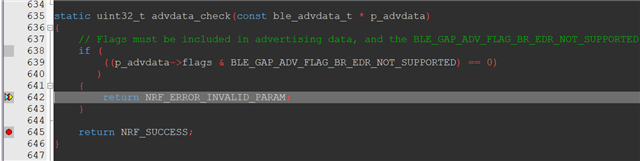

I also try to switch the flag in advertising_init() directly to BLE_GAP_ADV_FLAG_BR_EDR_NOT_SUPPORTED however the advertising mode seems to go to IDLE directly which result in sleep mode enter.
Since I am new to Bluetooth and embedded system. This might be a stupid question. but Could you kindly let me know how to fix this problem?
    This should be working, and I think you have made a mistake when attempting to port the use of whitelist to your application. Can I see some more of your code?
    One note: From the logs I see that you do directed advertising. This is used for time-critical reconnects, and it is probably not needed in you implementation.
  • Thank you Håvard for the fast response and the note about direct advertising. My code uses ble_ant_app_hrm example as a template. I separate  BLE part to be BLE Agent which is as below. I also change quit a lot of initial settings while trying to make bonding and dfu works. It is quit messy since I am still just testing on it ><"

    To be honest, I don't know much about debugging. The call stack is always showing "app error fault handler" from KEIL. I also try using Segger studio but it shows only call stack 0x000008c8. Is it normal to be like this?
    Therefore I try inserting breakpoint at all the places that returns NRF_ERROR_INVALID_PARAM in adv_data.c and it seems like it came from advdata_check(). I notice that when I delete all bonds and start the program. It also returns NRF_ERROR_INVALID_PARAM, but the program keeps on running without error when i continue running it.
    below is the call stack when the program start with nothing stored in the whitelist. It returns NRF_ERROR_INVALID_PARAM but no error occur to stop the program.
    below is the call stack that returns NRF_ERROR_INVALID_PARAM after I add the first device successfully to the whitelist and then disconnect from it. So looks like on_timeout is what cause the advertising error handler() to stop the program.
    When  there is exist  a whitelist, NRF_ERROR_INVALID_PARAM returned with the below call stack will cause the app error fault handler to stop the program.
    does this mean there are something wrong with the p_advdata->flags?
