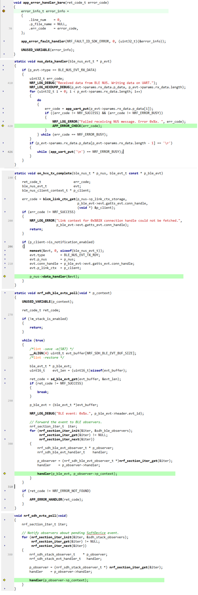

        uint32_t err_code;
            do
                if ((err_code != NRF_SUCCESS) && (err_code != NRF_ERROR_BUSY))
                    NRF_LOG_ERROR("Failed receiving NUS message. Error 0x%x. ", err_code);
        if (p_evt->params.rx_data.p_data[p_evt->params.rx_data.length - 1] == '\r')

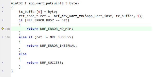

I am able to send only one character (for example "6") through the mobile app with the UART service. The chip is receiving it and printing it in the terminal.

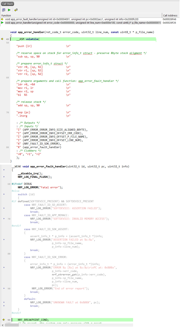

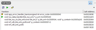

When I try to send more (for example "62") I got crash and reset. Below is the call stack provided by the debugger:
I believe error 0x08 refers to NRF_ERROR_INVALID_STATE.
Any suggestion what may cause such behaviour?
