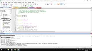

Hi, im using nRF 52 DK. I want to interfac mpu6050 by using the example found on this page https://github.com/Martinsbl/nrf5-mpu-examples. I'm particularly using the example linked below, which uses twi. I need to biuld this example and download it on my nRF52 to send the acquired data to my smartphone by using BLE. But I have an error saying that the file app_mpu.h cannot be found (but it is there). How this can be done? Any help would be appreciated! P.S all of this is done using softdevice s132 and SDK 14.2.0.

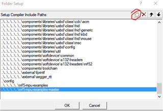

    Also you could right click on the folder above Application, press Options for Target '....', go to the C/C++ tab, press on the ... button to the right of include paths, scroll all the way to the bottom & change nrf5-mpu-examples to nrf5-mpu-examples-master. The app_mpu.h file is located inside this nrf5-mpu-examples-master folder. You need to go back 5 folders from the Keil project to reach the nrf5-mpu-examples-master folder, which is why the last line should look like this: ..\..\..\..\..\nrf5-mpu-examples-master (Tips from similar thread)

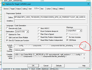

  •  include the path to app_mpu.h file in c/c++ preprocessor.
    Go to "Options for Target":
    Then "C/C++" tab --> include paths:
    Include the path where "app_mpu.h" is located:
    (in my case [... nRF5_SDK_14.2.0_17b948a\examples\nrf5-mpu-examples-master] )
