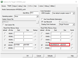

  • Do you have debug logging enabled? It should print out the lowest RAM address you can use with current configuration. Alternatively, just increase the RAM start address by ~20 bytes or more, enough to store the new base UUID. Just let me know what toolchain/IDE you use if you are unsure on how you can do this.
  • I use Keil (uVision5).
    I found RAM start address (0x20000000). I changed this value, but it was not resolved.
  • RAM_START_ADDRESS should not be changed, it's used to calculate the total RAM area. Configuration of the application RAM address is done in "options for target":
  • I'm really thank you!! Vidar Berg!!
    I solved the problem with your help .
