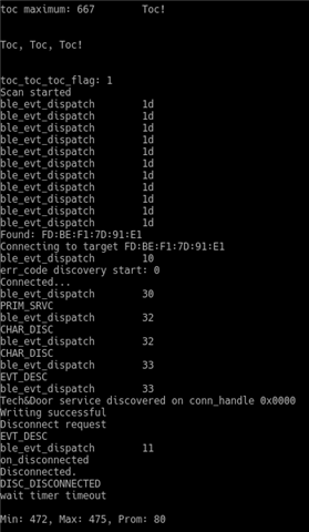

I have a BLE Nano from Red Bear Lab that has a nRF51822 doing adv and it expose my own service, when I write a key in one of its characteristics value it opens a door, this works fine when I do this from an Android phone with the nRFConnect app.
Now I am trying to do that without the phone, so I flashed a central code to another BLE Nano that when it receives some external stimulus it starts to scan, connect, discovery, write and finally disconnect from the peripheral device that opens the door.
Using uart for debug and printing a message each time the device go to the ble_evt_dispatch() like this:

It works well most of the time, but some times the central device start scanning, then it connects to the peripheral device, and for an unknown the next dispatch event is the BLE_GAP_EVT_DISCONNECTED, this means that for some reason it connects and then disconnects without discovering the peripheral services,

    I did it, it gave me the idea of the discovery events, but the problem continues, sometimes the device disconnects before doing any discovery.
    These are the messages when it works fine,
    these are when it works wrong
    In my central app, the sd_ble_gap_disconnect() function is called when a GATTC or GATTS TIMEOUT event occurs, and before going there the device had to go through the dispatch, and finally is called after the client has written in the characteristic.

  • Maybe the peripheral's application crashes?
    Can you try to print the disconnect reason within the Disconnected event?
    Do something like this in the BLE_GAP_EVT_DISCONNECTED event in main.c:
        printf("Disconnected, reason: 0x%02x\r\n", p_ble_evt->evt.gap_evt.params.disconnected.reason);
    and see if you can see the disconnect reason.
    How long is the time between the connected and the disconnected event?
    Can you see whether the peripheral device resets at some point, or if it is running continuously the times when the central can't discover the services?
    Edvin
  • Hello Edvin,
    The disconnect reason is the BLE_HCI_CONN_FAILED_TO_BE_ESTABLISHED 0x3e, its a little difficult for me to debug the peripheral device in this moment, because it is in service, so I retry to connect 3 times if the disconnection reason is BLE_HCI_CONN_FAILED_TO_BE_ESTABLISHED 0x3e for a fast solution, I'll try to debug the peripheral, and I'll tell you what I could see.
