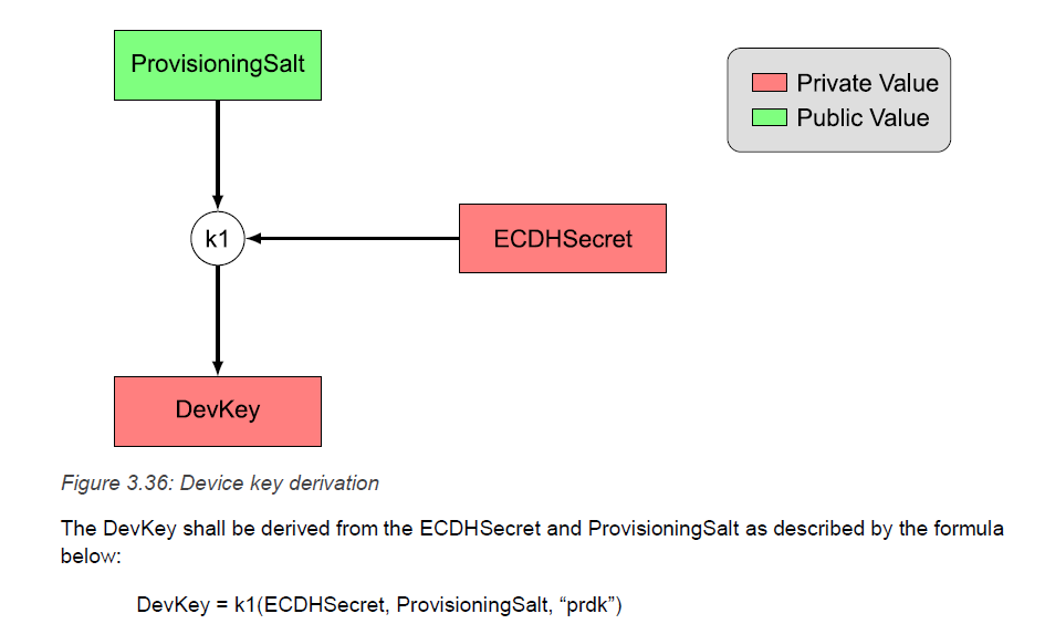

When complete provision a provisionee , provisioner will assign provisionee a mesh key and device key.
Now i want to know how to calculate the device key , any API can I use ?

hello,
From the SIG Mesh specification...
And within the nRF5 Mesh Stack... look into the light_switch_provisioner example (prov_utils.c) for the prov_utils_derive_keys function:
/* DeviceKey = k1(ECDHSecret, ProvisioningSalt, "prdk") */
enc_k1(p_ctx->shared_secret, NRF_MESH_ECDH_SHARED_SECRET_SIZE,
provisioning_salt,
DEVICE_KEY_INFO, DEVICE_KEY_INFO_SIZE,
p_device_key);
