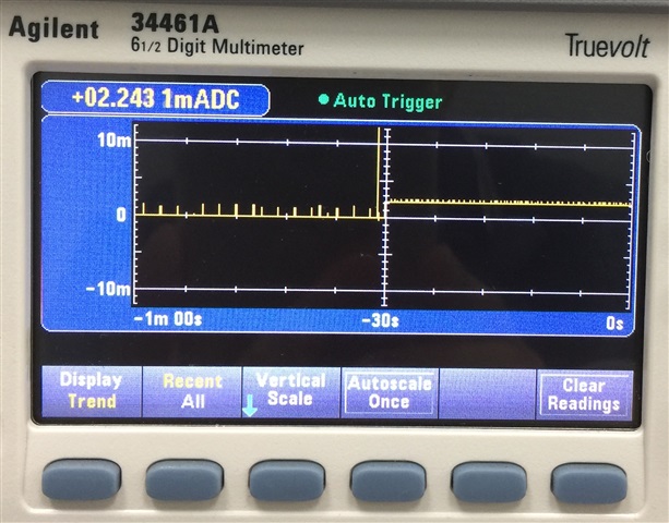

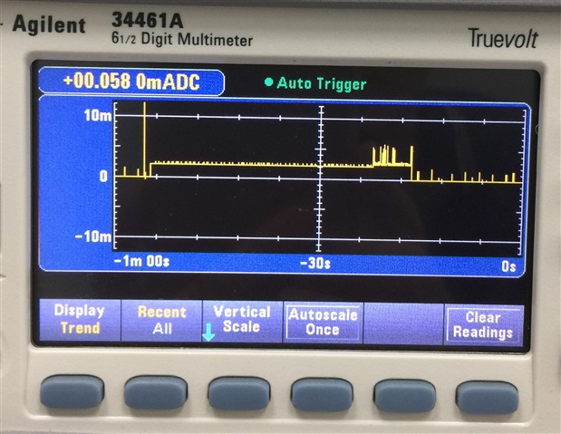

I find a high current issue with UART. The current is around 58uA as I expected after power startup with RX and TX pins
connected to a USB to TTL dongle.
But if the Rx and Tx pins are not connected and power up nRF52832, the current goes to 2.24mA. At this moment if I connect
the Rx and Tx pins, the current will go to 58uA.

  • The USB to TTL dongle will provide power to the nRF52832 via the internal schottky protection clamp diodes unless the USB to TTL voltage (typically 3.3 volts) is the same as the nRF52832 Vdd (typically 2.8 volts or less). With the Rx and Tx line disconnected you are seeing the true consumption, with Rx and Tx connected the measured value is incorrect. As a test, use the USB to TTL dongle voltage as the Vdd source for the nRF52832; usually this is available on a header unless it is the encased type. When connected thus the Rx and Tx will work but you will see the higher current consumption.
    This is commonly referred to as phantom power.

        This morning I do several tests based on the "ble_app_uart" code. I add a 10ms APP_TIMER to be the same with my
    appliction code. The following are the test conditions and results:
    Items / Conditions / Results
    1/ Uart not initialized / current is normal (46uA)
    2/ Uart initialized / current is kept high (2.26mA)
    3/ Uart initialized; UART disabled by app_uart_close() after  ble_stack_init() / After power on, the current is kept high (2.26mA) for several seconds.
    4/ Uart initialized; UART disabled by app_uart_close() before ble_stack_init() / The current is normal as test item 1.
    All the above test conditions are Rx and Tx pins disconnected. The nRF52832 is powered by USB_TO_TTL dongle 3.3V.
