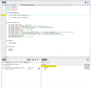

  • This code should work. I took your code and did a few trivial adaptations to be able to test it on the nRF52 DK. I expect it will work on any nRF5 device, though.
    void TIMER0_IRQHandler()
        if (NRF_TIMER0->EVENTS_COMPARE[0] != 0)
            NRF_TIMER0->EVENTS_COMPARE[0] = 0;
    void timer_config(void)
        NRF_TIMER0->TASKS_STOP = 1; // Stop timer
        NRF_TIMER0->MODE = TIMER_MODE_MODE_Timer; // taken from Nordic dev zone
        NRF_TIMER0->BITMODE = (TIMER_BITMODE_BITMODE_24Bit << TIMER_BITMODE_BITMODE_Pos);
        NRF_TIMER0->PRESCALER = 8; // 1us resolution
        NRF_TIMER0->TASKS_CLEAR = 1; // Clear timer
        NRF_TIMER0->CC[0] = 62500;
        NRF_TIMER0->INTENSET = TIMER_INTENSET_COMPARE0_Enabled << TIMER_INTENSET_COMPARE0_Pos; // taken from Nordic dev zone
        NRF_TIMER0->SHORTS = (TIMER_SHORTS_COMPARE0_CLEAR_Enabled << TIMER_SHORTS_COMPARE0_CLEAR_Pos);
        //attachInterrupt(TIMER1_IRQn, TIMER1_Interrupt); // also used in variant.cpp to configure the RTC1
        NVIC_EnableIRQ(TIMER0_IRQn);
        NRF_TIMER0->TASKS_START = 1; // Start TIMER
    void setup()
        timer_config();
        setup();
        while (1);
    The IRQ handler is called, verified by the breakpoint, as you can see from the screenshot.
