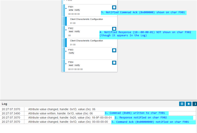

My service (nRF52832, peripheral, SDK14.2) works in a control point / response manner:
  1. Command code is written by central to 'Command' char (F901). On peripheral it is handled by 'on_write' handler
  2. Handler notifies the response to the central on the 'Response' char (F902)
  3. Handler acknowledges the command on the 'Command' char (F901)

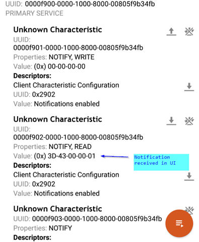

in nRF connect log (bottom half of the screen) I can see the transactions described above but for some reason in the main window F902 is not updated with the 'Response' value...
Is it a problem with nRF_Connect or my code? Can I respond with Notification(s) while processing Write transaction?
Attached is a screen cap, (worth 1000 words :)
