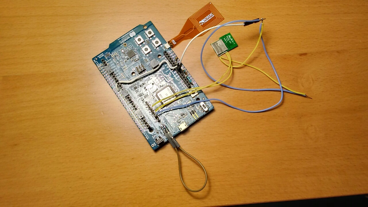

  • It works for me with no changes to a nRF SD52 straight out of the box. P19 is not the same as P20, P19 uses EXT_GND_DETECT whereas P20 uses SH_GND_DETECT. Does it matter? Who knows, they go to different pins on the SAM Segger interface  .. but see these photos, They shows P19 correctly programming a target board. When P19 is unplugged the nRF52 DK device is instead programmed. Why such a complicated set of adapters? Because I use 6-pin Tag Connect not 10-pin Tag Connect and we can't find a suitable single adapter.
    The equivalent Adafruit connector also shown with 4 wires plugged in as shown does the same job. All the grounds are correctly handled by connections on the adapters whichever of these two options you use. There are no modifications on any of these items.
