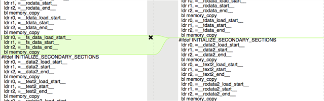

    I think I found the issue with the flash.
    I assume that you have seen this porting guide to port projects from Keil to SES.
    I see that our thumb_crt0.s are a bit different. I use Segger Embedded Studio v3.40. I suspect that many of the differences are a due to that we use different versions, but as it mentions in the guide, you should change one thing in your thumb_crt0.s file.
    ldr r2, =__tdata_end__
    bl memory_copy
    # ADD HERE ...
    ldr r0, =__fs_data_load_start__
    ldr r1, =__fs_data_start__
    ldr r2, =__fs_data_end__
    bl memory_copy
    # TO HERE ...
    I see that you have something similar, but there is some typos.
    In your thumb_ctr0.s it says:
      ldr r1, =__start_fs_data
      ldr r2, =__stop_fs_data
      bl memory_copy
    Try to change
    __start_fs_data   and
    __stop_fs_data
    to
    __fs_data_start__    and
    __fs_data_end__
    as it says in the porting guide. Also, try to use the flash_placement.xml file to the one that is linked in the guide (the one that is meant for sdk14).
