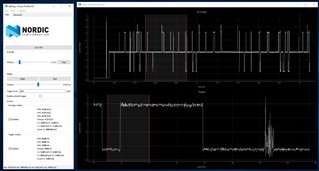

our product is small tag, size of 70x35mm2.
Plastic covers are welded together and now looks like after welding some HW does not work properly. Flashing is successful, but it does not operate as it should. It looks like it is in some sort of reset loop. Average current consumption is about 4mA, so it look like CPU is operational.
Yes, we have sleep clock with low frequency oscillator and crystal. We know that crystal is sensitive for ultrasonic, but it does not help when we have changed the crystal.

    Still, I fail to see how a broken bonding wire would cause this issue. What is the reset reason? Do you measure stable voltages on all DEC pins (except perhaps when resetting)? Have you changing the LF clock source, or running a simple code that just initializes the oscillators, and reports the outcome e.g. by toggling a GPIO?

    LF clock is running, voltages are ok in all pins, flashing is successfull (=>HF clock is running), but device's average (continuously) current consumption is about 4mA. Regularily there is 7mA current pulse, see figure.
    I will continue studies...
