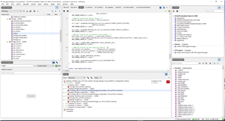

I down the newest version of thingy. i build it fail .why??
Hi Iwque,
Where did you dowload that project?
Is this a unmodified project?
Usually, when those error comes up there are some incorrect paths in the "linker option".
also double check that those files reported actually is in the "\source\modules" folder.
yes ,it is a unmodified project.i download from this below.
i find there are not exist in the SDK document. so they are lost.why ???
Hi Iwque,
Thanks for your reply.
Unfortunately, the "ses" project folder was added in the Thingy SDK as a mistake since we do not have sufficient support for it yet.
It will be working properly in the next Thingy SDK release thought.
So for now you either have to use Keil or GCC. More information about this in this thread.
Also, mentioned in the thread linked to, it describes that you could port the project from Keil to SES yourself so that is an option.
(also, if you get "can't find ../../../libs/libmpllib_Keil_M4FP/libmpllib.lib" when compiling check this thread)

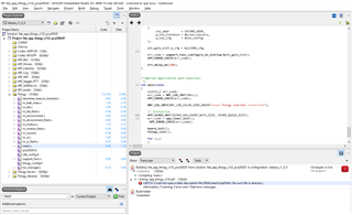

yes .i can build in keil successfully now.
i can import keil 5 project into SES successfully.
it build fail when i modify the code in the SES. However it can build successfully in keil 5
information below:
Hi Iwque,
We are planning to support SES in the future, but we currently don't have a confirmed date for when SES support will be added.
I am sorry for the inconvenience.
