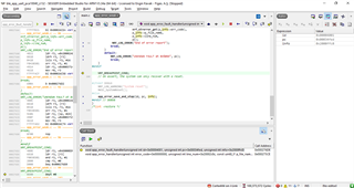

       I am having a trouble with my code. There is an RTC sensor Which has the address 0x32. When the sensor is connected to the TWI lines, there is no problem and it works perfect. When I disconnect the sensor, the MCU crashes and "app_error_fault_handler" is called.
      How can I elliminate this problem ? I need to write a working code even if there is no sensor on the TWI line.

  • Hello Enkavak,
    Could you debug your code and set a breakpoint in the error handler? (it would be really helpful to see what causes this error)
    You should also turn on RTT logging in "sdk_config.h" and run RTT viewer (if you haven't).

  • Hello I set a break point in the error handler and I get the result below.
    I do not want to use twi_handler.
    I enabled the RTT viewer. However I get nothing. It is not working. Is there a document about How tou use RTT viewer ?

  • RTT Response
    0> <info> app: Debug logging for UART over RTT started.
    0> <error> app: ERROR 33281 [NRF_ERROR_DRV_TWI_ERR_ANACK] at E:\Yedek\nRF5_SDK\examples\ble_peripheral\ble_app_uart\rtc.c:27
    0> PC at: 0x00034FED
    0> <error> app: End of error report
  • Hi Enkavak,
    Well, one suggestion is that you could search if something is on the TWI address 0x32 (use the twi scanner as reference)
    If not, then do not use the TWI.
    From your RTT output:
    Set a breakpoint at line 27 in rtc.c file and debug the code and check the call stack to see what functions directs you into the error.
