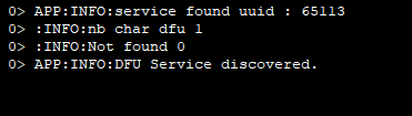

  • UPDATE : i found a other way to discover the service and it's working fine. I'm back to my first issue where i can't discover all the characteristics i do the discovery like this :

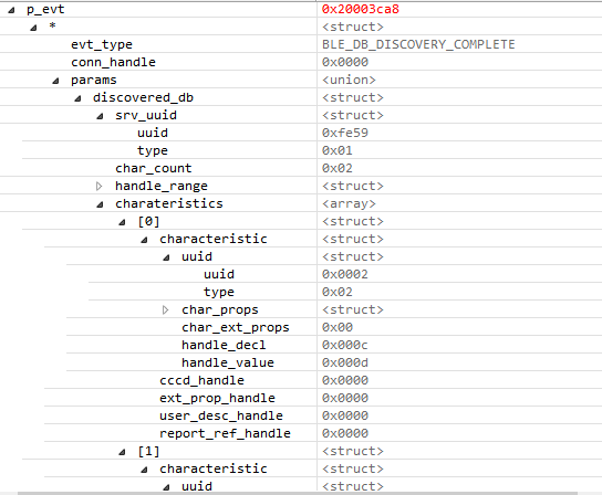

    unfortunately no characteristics are discovered the switch is going strait to default insted of discovering
    the DFU without bound characteristics (0x0003). I still get the right number of characteristics but the wrong UUID.
  • Are you sure you've set the correct base uuid? Note that it is not the same as the one used with the NUS.
        uint8_t uuid_type = BLE_UUID_TYPE_VENDOR_BEGIN;
        ble_uuid128_t const base_uuid128 =
                0x50, 0xEA, 0xDA, 0x30, 0x88, 0x83, 0xB8, 0x9F,
                0x60, 0x4F, 0x15, 0xF3,  0x00, 0x00, 0xC9, 0x8E
        err_code = sd_ble_uuid_vs_add(&base_uuid128, &uuid_type);
    Here is the result from my test (used NUS client example from sdk 15 as starting point):
  • That actually was it, wow i can't belive i made a such stupid mistake...
