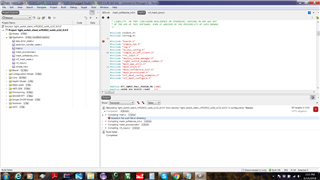

Thanks for reply. yes it is compile in SDK14 and SDK15 . I want to compile latest Mesh SDK. I am going to test light_switch example. Here i want to combine Mesh SDK and SDK14 or SDK15 ? Because i facing below error
Hi Murugan,
Remember that the nRF5 SDK for Mesh now requires the nRF5 SDK to compile.
