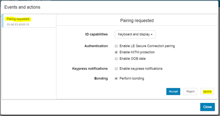

I am running gls example on SDK14.2.
I paired after flashing program to my DK board, and then turn off power.
And turned on again, but i can't connect to my DK board( nRF connect show that the gls is bonded ).
Why?
