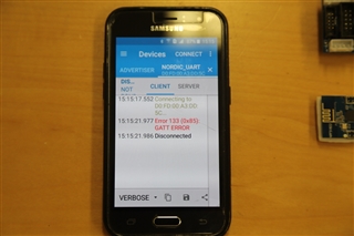

ble_app_uart with Android 5.1 failed
I try launch example Nordic UART and get error: Error 133 (0x85) GATT ERROR

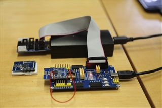

Chip:  nRF51822 QFAA
SDK:   nRF5 SDK works with S130 v2 12.3.0
Softdevice: S130-SD-v2 S130 nRF51 SoftDevice 2.0.1
Test board: PCA10001

  • Hi Martin.
    I use custom board with nRF51822 QFAA H10 (0x008f)
    This chip with revision 3...

    I can see device in RF, but device unconnectable.
    nRF Connect LOG display give:  Error 133 (0x85) GATT ERROR
    1. What happens with your board after it disconnects? Does it reset?
    2. Have you debugged your board?
    3. Do you get any logging info out of the nRF51?
    4. Could it be that the application fails?
    5. Do you have a development kit or a different board that you can try the same code on?
