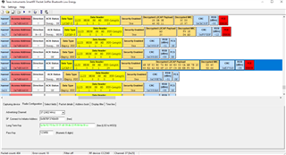

  • i am using CC2540 sniffer and version of my softdevice is 13, when i use sniffer to sniff the ble packets, it show something like this:
    as you can see i entered the pass key and also sniffer detected the LTK, but still do not encrypt packets and i  could not see the packets raw data.
    thanks for your response
  • I see that you have entered an LTK, but still, the LTK is the prime suspect for faulty decryption.
    Try deleting the bond on both sides, then connect and bond. And let me see the key exchange that happens.
