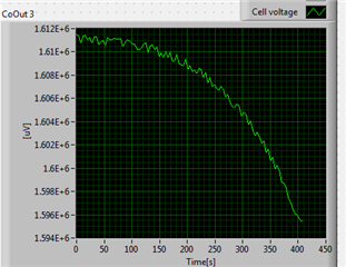

  • Hi Kiyoshi,
    I believe our test lab are narrowing down the different causes. I can add a few of the measurements here:
    Noise on ADC measurements due to noise on internal reference voltage (0.6V):
    Noise on CRC2032 during sampling (128x bursts):
    Cell voltage of CR2032 over temperature:
    Both above measurements are without radio, which will cause even more noise.
    As it looks now the recommendation will be to use external reference (VDD/4), but the external reference can't be a CR2032 directly.
    My suggestion to confirm is to use 1xAAA (or 1x AA) for analog input, and 2xAAA (or 2x AA) for supply voltage (with short wires). The external crystal oscillator should also be started before measurements, since the internal RC oscillator is influenced by temperature.

  • Hi Kiyoshi,
    The noise in internal reference is temperature dependent, and likely the main cause of your issue.
    The frequency of the internal RC oscillator is also temperature dependent, and will influence measurement.
    You wrote you also experienced noise when using external reference(VDD/4), and we believe the cause of that is CR2032 is not linear over temperature, we can see that there is noise from CR2032 (VDD and analog input), the noise depends on current consumption (burst sampling) and temperature.
    Kenneth
  • Kiyoshi Iwai said:
    You mean that nobody can use the internal reference 0.6V with CR2032, right?
    I think that will depend on the required accuracy of the ADC measurements, but for 12(14-bit with oversampling) you likely will not be able use the internal reference or a CR2032 directly no (but possibly with an LDO).
    Kenneth
