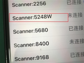

Nrf51822 device name display is abnormal
    const uint8_t name[]={"Scanner:"};
    uint8_t device_name[12];
    uint32_t ID_num= m_device_info.Device_UNI_ID % 100000;
    memcpy(device_name,name,8);
    device_name[8] = (ID_num%10000)/1000 + 48;
    device_name[9] = (ID_num%1000)/100 + 48;
    device_name[10] = (ID_num%100)/10 + 48;
    device_name[11] = ID_num%10 + 48;
                                          (const uint8_t *) device_name,
                                          sizeof(device_name));
Device:Nrf51822
SDK:SDK12.3
Device name consists of "scanner:" and four digits。But sometimes the device name display error。An extra character appears in the device name string。 As shown below:
    What device do you use for listing the devices? I see that it is a phone from the picture, but what application does it use? Do you see the same in nRF Connect?
    What sort of devices are you Scanner:nnnn?¨Are they advertising their names? Or are you connecting to them to see the names?
    If they are advertising, can you please try to get a sniffer log when the name is displayed incorrectly?
    Edvin
