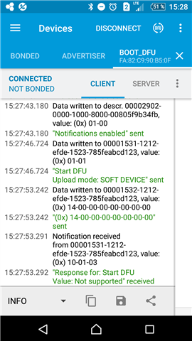

I work on project for BLE communication in DFU mode.

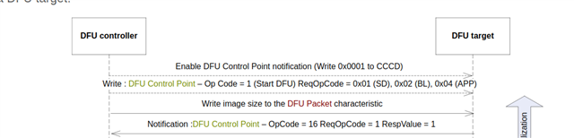

I am testing according to the mode defined on the Nordic web page link
I did the tests with the BleuZ and with an android application nRF.
I start with enable CCCD, then I write the [01 01] on the characteristic DFU CONTROL POINT and [14 0 0 0 0 0 0 0 0] as size of the packet on the other hand on the response I always receive [10 01 03] knowing that I must receive [0x10 0x01 0x01] -> decimal [16 1 1].
image app
could you help me please.
