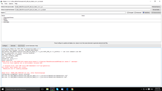

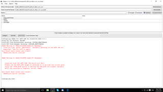

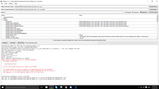

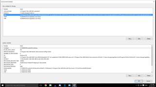

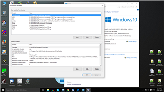

i want to test Ble mesh Light switch demo using cmake with nRF51 controller.i m facing below error.
Please suggest me ASAP.

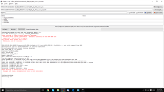

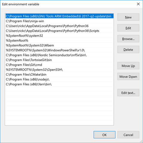

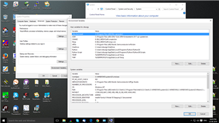

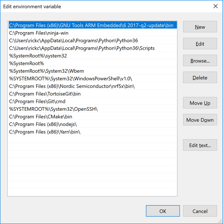

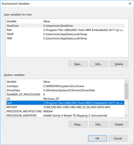

Hello Nikunj,
Please add the Ninja path to the windows "environment variable" and try to "configure" again.
Hope this can do help :)

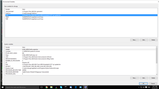

Have you tried to reboot your PC after changing system variable?
yes i have restart my system every time when i change in system environment variable.

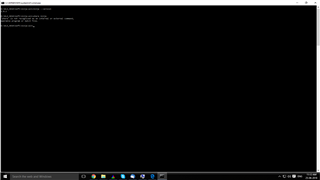

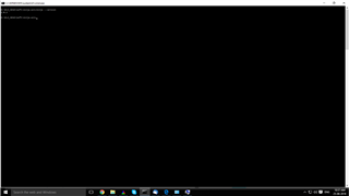

Please open the command prompt, and do not navigate to the Ninja path, type again the following commands and post the result:
where ninja ninja --version
If you still see any error, then there's something wrong with your environment variable setting.

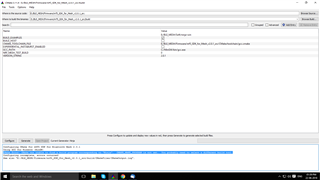

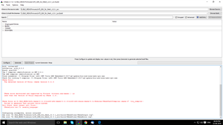

Hi Rick Chung
Thanks for support ..I have done & generate hex file with ninja
