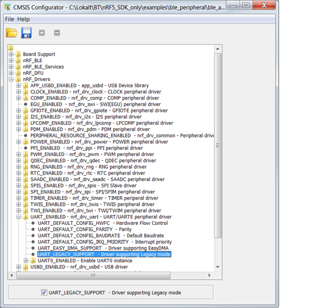

  • I have no idea where you got that lovely configuration screen.
    Can you tell me what #defines it generates into sdk_config.h?
  • It is from Keil.
    Here is the text format from sdk_config.h file:

  • I am using a separate tool for working with the sdk_config.h. It is called "CMSIS Configuration wizard" and can be downloaded from here http://helmpcb.com/software/cmsis-configuration-wizard:
