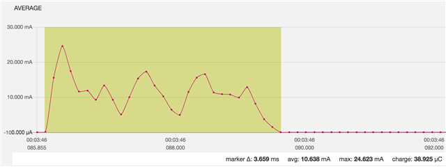

At +4dBm, I expect an average of 3.604mA over 4.644 milliseconds based on the online estimator, but instead the PPK measures 10.638mA average over 3.659 milliseconds with a similar peak of 24.623mA at the beginning.

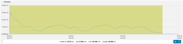

  • Thanks- I figured at least part of it out. We have DCDC hardware, and I was under the impression that we had enabled DCDC. The developer that wrote the initial code did make a call to sd_power_dcdc_mode_set(NRF_POWER_DCDC_ENABLE) during initialization, but there were two issues. 1)  POWER_CONFIG_DEFAULT_DCDCEN wasn't set to 1 in sdk_config.h, and 2) the sd_power_dcdc_mode_set() call was being called before the softdevice was initialized. So I changed the setting in sdk_config.h and moved the sd_power_dcdc_mode_set() call to after softdevice initialization, and current during advertisement definitely dropped. Here are the before and after captures from the trigger window of the PPK.
    Edit: Actually I guess maybe the sdk_config.h setting doesn't matter if I explicitly call sd_power_dcdc_mode_set() after the softdevice is initialized?
    Without DCDC properly configured:

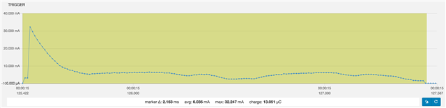

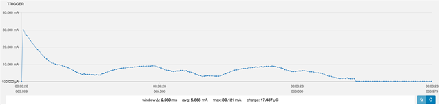

    So the average current dropped significantly (average 9.480mA for 3.016ms down to average 6.035mA for 2.163ms), but there's still that big 30mA spike at the beginning. As I understand it, high current spikes can be detrimental to batteries (especially coin cells) so I'd like to understand why it's there.
  • I'm not sure what the 30mA spike is, but I think the measurement resolution is very low on your plots, so then it's hard to tell. Are you able to get something that looks like this?
  • The resolution, both horizontal and vertical, looks very similar to me. I think our curves are just shaped very differently. Here's another capture zoomed in a bit to show dots on each sample.
