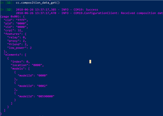

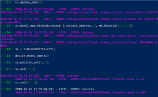

When a provisioner finds the device it starts the provisioning process, it goes correctly, got a node addreess( tested this with a DK board as provisioner,  another DK board as client and a DK running my merging code, also performed this step using the interactive python demo).
Then is receives the composition_data_get, tries to process it, but fails on sending the packet.

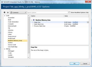

My guess is that something is mesing on the sdk_config or the nrf_mesh_config_app but not shure.
