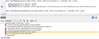

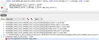

    I haven't been able even to build the solution. I'm still struggling with the reply_status function and the get_cb on the handle_get_cb...
    I tried to use pointers to return 3 parameters in the main.cb, as follow:
    static bool on_off_server_get_cb(const simple_on_off_server_t * p_server, uint8_t * current_red_dt_cycle, uint8_t * current_green_dt_cycle, uint8_t * current_blue_dt_cycle)
        //return hal_led_pin_get(LED_PIN_NUMBER);
        * current_red_dt_cycle = red_duty_cycle;
        * current_green_dt_cycle = green_duty_cycle;
        * current_blue_dt_cycle = blue_duty_cycle;
    But I still don't know how to modify the get_cb to accept 3 parameters (I can't even find where get_cb is defined):
    So, until I figure out how to solve this, I can't run it and check what access_model_reply() returns.
