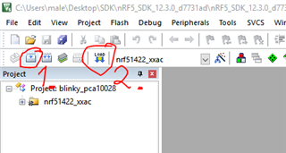

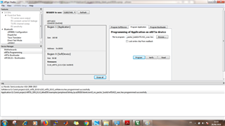

I'm trying to program a NRF51822 module for the first time.Using Keil, Soft device s110_nrf51_8.0.0,soft device kit nRF51_SDK_9.0.0_2e23562 when I try to program  I get an success  message  but no blinking of the LED
Please see below. Any clues?

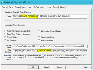

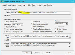

  • Hi Barus,
    I can still see that you are not using the SDK version I recommended.
    --> Please Download SDK v12.3.
     There should not be a problem for you using Keil.
    --> Since you are using the PCA20006 board you have to enable support for that board as shown here. (define 'BOARD_PCA20006' in C/C++, ASM)
    - And you don't need to flash the Softdevice if you are not using a BLE application. (which the regular blinky example is not)
