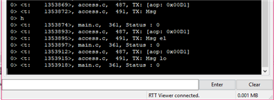

  • Now this function __LOG(LOG_SRC_ACCESS, LOG_LEVEL_DBG1, "TX: Msg %s\n", p_tx_message->p_buffer) work for printing the message, I don't know why it doesn't at first when I added it, but now my problem is when I send data from pc (termite terminal) to my board and send it over mesh, It will be sent like this
    this is the log of the sending side
    here what I receive on the othe side
    and here is a snippet of my code
    for (;;)
            (void)sd_app_evt_wait();
           // uint8_t cr;
            char s[5];
          uint32_t status = NRF_SUCCESS;
          // while (app_uart_get(&cr) != NRF_SUCCESS);
          // while (app_uart_put(cr) != NRF_SUCCESS);
         uart_getstring(s);
         uart_putstring(s);
         printf(" message : %s \n ", s);
         send_my_message(s);
    This is my send_my_message() function
    void send_my_message (uint8_t* s)
        uint32_t status=0;
        uint8_t buffer[5];
        strcpy(buffer, s);
        uint8_t length;
        access_message_tx_t msg;
        length= sizeof(buffer);
                 if (length)
                      msg.opcode.opcode = simple_message_OPCODE_SEND;
                      msg.opcode.company_id = 0x0059; // Nordic's company ID
                      msg.p_buffer = (const uint8_t *) &buffer[0];
                      msg.length =length;
                     status= simple_message_client_set_unreliable(&m_clients[0], buffer, length);
                     __LOG(LOG_SRC_APP, LOG_LEVEL_INFO, "Status : %u \n", status);
                      if (status == NRF_ERROR_INVALID_STATE ||
                      status == NRF_ERROR_BUSY||status == NRF_ERROR_NO_MEM)
                         __LOG(LOG_SRC_APP, LOG_LEVEL_INFO, "Cannot send. Device is busy.\n");
                          hal_led_blink_ms(LEDS_MASK, 50, 4);
                       else
                             ERROR_CHECK(status);
    The string data is sent separately, please help
    Thank you

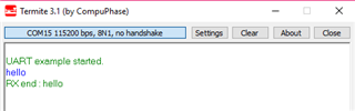

  • Hi again,
    I want the data that I receive on UART (string data) to send it over mesh, I tested with array of bytes as you said and it works, but in my case I want to get any data sent by pc terminal(termite) to send it over mesh, I did a lot of tests and nothing wrong with mesh, now I switch using this function  to get data from UART:
        if (p_event->evt_type == APP_UART_DATA_READY)
            s[Index++] =  cr;
            s[Index] = 0;
            if(cr == '\n')
                printf("RX end : %s\r\n", s);   //show nothing
                send_my_message(s); //fail here
                Index = 0;
        if (p_event->evt_type == APP_UART_COMMUNICATION_ERROR)
        else if(p_event->evt_type == APP_UART_FIFO_ERROR)
    So this function works fine when I don't add send_my_message() function as shown in line 11 above in code, but when add it,  it stuck and the function shows nothing
    here is result without send_my_message() function
    and here with send_my_message() function
    send_my_function() is mentioned in my previous comment, please help
    Thank you

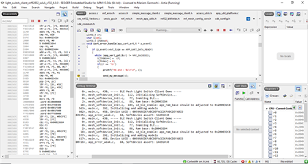

  • Can you check what when wrong when you call send_my_message() ? any assertion ?
    Did the application run normally after that or it crashed ?
    How did you setup  __LOG  ? via RTT or UART ?
    If you printing out log via UART you will have a conflict with your printf.
    If you comment out printf do you receive the data on the other node in mesh ?
  • Here's what happen when I call send_my_message(), there is a softdevice assert and a warning:  mesh_softdevice_init.c,  104, sd_ble_enable: app_ram_base should be adjusted to 0x200032C8
    For the setup  __LOG, I'am not sure if you talk about this
    or the setup in sdk_config.h, actually I added the setup_config.h of the uart_example and add some defines from sdk_config.h of client example because I delete it from the project but in both files there is no defines for rtt or uart log enable, there is only nrf_log_enable which is set to 0
    If I comment out printf, I don't receive any data on the other node and still have the same problem
