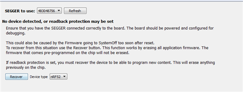

I'm getting errors on trying to program a custom board using the Laird BL654.
We are verifying manufacturing results with an x-ray of a populated board tomorrow checking for voids or shorts. While we're trying to rule out any manufacturing errors on our end, I wanted to get input on these programming errors.
The two errors are visible in nRFgo Studio, nRF Connect's Programmer Tool, but also the nrfjprog command line.
The SWDIO line has activity verified with scope.
nRFgo Studio:
Clicking under "nRF52 development dongles -> Segger XXXXXX"  Briefly Flashes:
And then the segger tool ejects from Windows and tries to re-mount as a drive. Recovery fails.
nRF Connect Programmer App:
Error when getting device info: Error: Error occured when open device long term. Errorcode: CouldNotOpenDevice (0x4) Lowlevel error: JLINKARM_DLL_ERROR (ffffff9a)
Error when closing nrfjprog: Error: Error occured when close opened device. Errorcode: CouldNotOpenDevice (0x4) Lowlevel error: JLINKARM_DLL_ERROR (ffffff9a)
I've also seen 'NOT_AVAILABLE_BECAUSE_PROTECTION' which in the documentation states that readback protection is enabled. Recovery attempts again do not work.

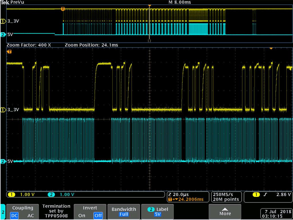

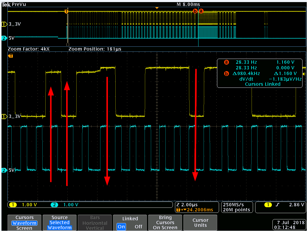

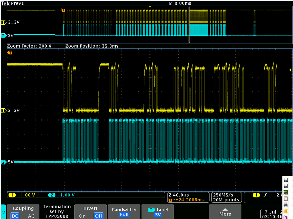

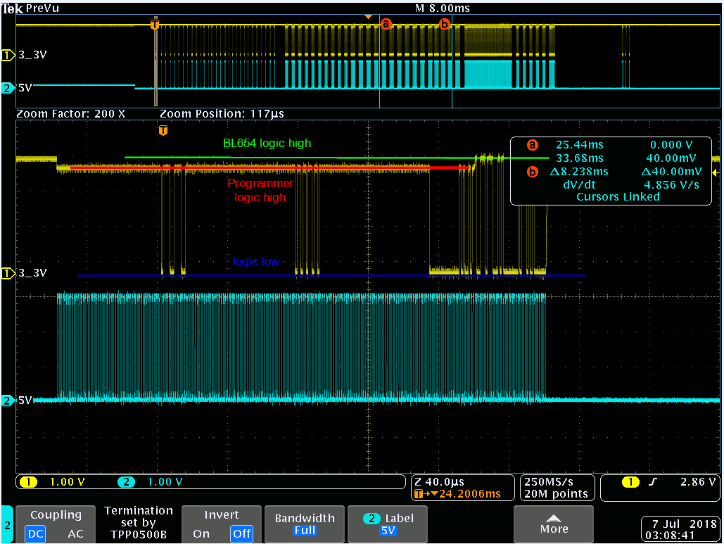

  • In connecting to the nRFgo Studio programmer by way of the Nordic Development board connected to my target using the debug header, I placed an oscilloscope on the data and clock lines during the failed attempt to connect.  The following set of figures is one capture from that exchange that takes place when a connection is supposed to take place between the programmer and the BL654 on my board.  You can see the entirety of the exchange across the top of the screen which lasted about 50ms long.  The main portion of each screen is a zoomed in section of the exchange highlighted by the white bars on the top portion of the screen.
    Here are my observations:
    1. Appears that the clock is running at around 1MHz.
    2. (see first figure below) I believe I see evidence of both the host communicating (Nordic dev kit programmer) and my board's BL654 responding as indicated by two different logic high thresholds visible in the data line.
    3. (see second figure below) Seems that the host (Nordic dev kit) is synchronizing data reads to the rising clock edge whereas the BL654 is synchronizing its data reads to the falling clock edge.... could this be the problem?
    4. (see third and fourth figures below) Appears to be evidence of programmer and BL654 talking over top of one another.

  • I was able to program one of the new prototypes.
    It had been giving troubles, but after reading the registers using the command line tool nrfjprog, I was able to load the soft device and application code is working.
    I am lead to believe there was either a manufacturing error, or the sample module(s) were dead on arrival.
    Their production release chips are now working with the normal process.
    Thanks for your help,
    Jeff
