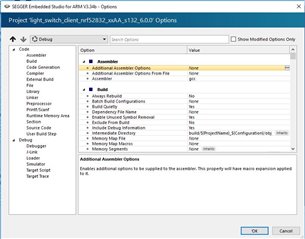

Hi Bjorn,
I have implemented mesh network using light switch example on nrf52832. I'm trying to give input using GPIO. I 'm getting a error when I add the gpiote.h to the client code. How do I add the path to gpiote.h in segger embedded studio?

This is how my project edit window looks.
