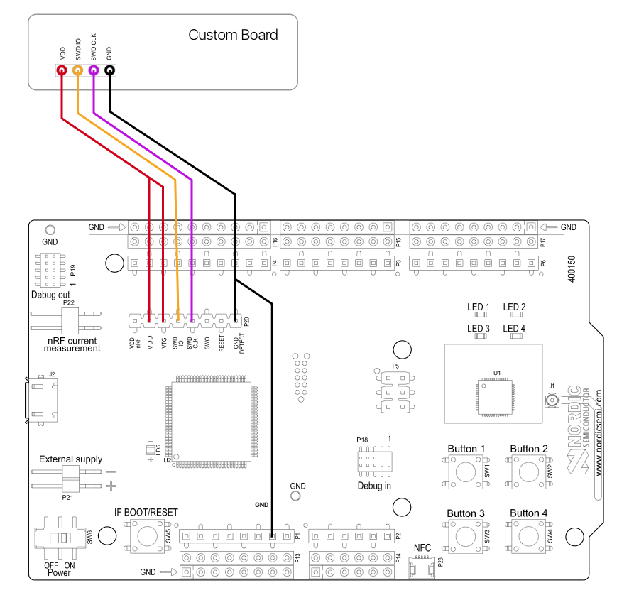

  • Thanks for your response, I unnderstand what you said but apparently i had already done and verified that the program does not go to the onboard BLE chip in 51DK. My connections are exactly as the ones in this diagram:
    sorry i pulled that image from the link you shared in your previous reply.

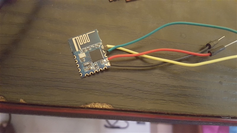

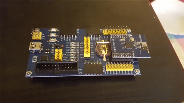

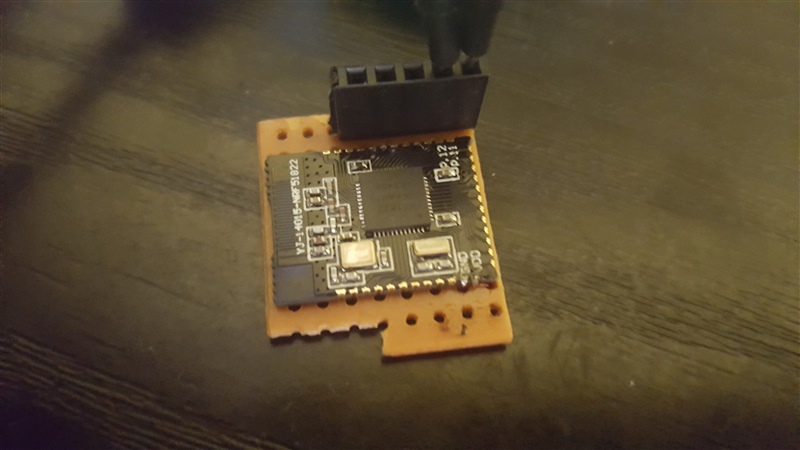

    But this is the case; When i used jflash lite to program or i just dragged and dropped the .hex file into the j-link folder, i got success (No fail.txt for drag and drop and "success" message for Jflash lite) on these three different boards and modules
    Module 1 Board 1.
    module 2
    Module 2
    module 3
    module 3
    The result:
    The program ran only on module 3. The program simply advertizes. So with no failures on the three modules when programming them, why would the other two modules not function as expected like module 3?. This is my frustration. do i need more than just supplying the VDD and GND 3.3v and 0 for the chip to function. I have checked the reference circuitry for nrf51822 theres actually no need for an external pull up on SWDIO. The modules just look lifeless when i power them with 3.3v from nrf51-DK board.  And if the chips (modules) are damaged should i have been able to do erase, program etc on them using jFLASH lite? Thanks as i hope for a reply.
  • Could you check that module #1 and #2 are actually powered as expected (~3V) from the nRF5x-DK?
    You only need VDD, GND, SWDIO, and SWDCLK connected to your external module.
    I'd recommend that you use J-Link Commander or nrfjprog (nrfjprog -e, nrfjprog --program <hex file>) for testing the connectivity of these modules instead of jFLASH Lite.
