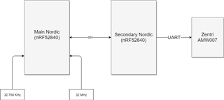

    My hardware setup has 2 nRF52840s- 1 Main and 1 Secondary connected via SPI. The Main chip alone has the external crystals connected and Secondary Nordic (Without external crystal) connected to the Zentri module over UART. Here's a block diagram:
    Do you think there's a way for me to calibrate the Internal RC of secondary chip with main nordic chip's clock? Doing this, I believe will help me to make the communication much more reliable at a baud rate= 921600.

  • Happy to help.
    Unfortunately this is not possible. And note that if you plan to use the radio on your Secondary nRF52840 it will need a HF crystal too. Radio protocols like BLE for example, needs very accurate clock sources (<40 ppm).
