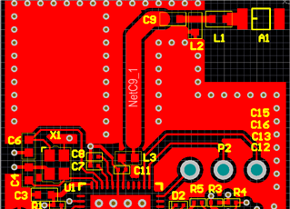

 I have designed a customized for nrf52832 with a trace antenna. I haven't used any low pass filter and made the changes inside sdkconfig.h file to use RC and that board worked fine (ble was advertising).

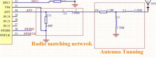

Now, I have designed a new customized board for the same but using chip antenna (712-1006-1-ND)  this time and also add low pass filter with 12pf capacitors. The part numbers for LPKF and antenna are given:
Antenna- 2450AT18B100E
LPKF- FC-135 32.7680KA-AC0
 But the problem is, the BLE is not advertising at all this time. I have removed the low pass filter also just to check if that causing the problem still its not advertising.
I have attached the screenshots for schematic and pcb. This time the board thickness is 0.6mm instead of 1.6mm and according to that thickness , the transmission line width is calculated as 47mils. Please let me know if that thickness is causing any issue? because as compared to the previous board( which was working fine), I have just done 3 changes-
1. changed the board thickness from 1.6mm to 0.6mm
2. add lpkf crystal
3. and changed the trace antenna to chip antenna
4. Also I have changed 0.8pf capacitor that I'm connectimg with the antenna from 0402 pack to 0201 (25v) (which is not the issue, i guess)

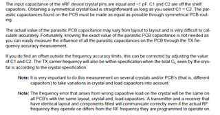

Also, is it possible that with decrease in board thickness, the 32mhz crystal is not working fine? ( Crystal orientation is perfect)
