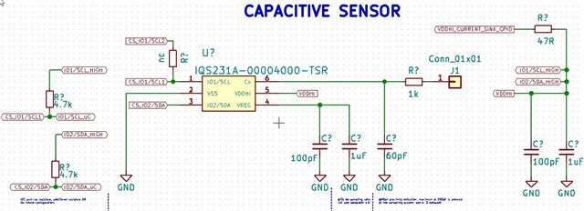

  • Here is a schematic for the current cap sense, with a pullup resistors of 4.7K:
    - SCL is routed to pin P0.27.
    -SDA is routed to pin P0.26.
    Note: I also also removed the pull-up resistors but it didnt work.

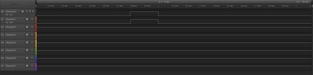

    As I mentioned above, when I run the code I get the following signal like this:
    Could you please tell me what am doing wrong, Thanks.

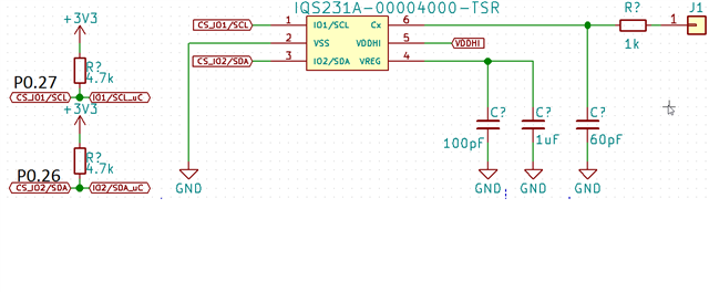

     Edit: This is the schematics of my settings. the resistor R/nc is not connected.
