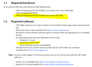

  • Having access to a BLE sniffer would be great, but it looks like there's no supported version for OSx as well as no hardware support for nRF52 dev boards (I'm seeing nRF51 but not 52).

  • Hi Erik,
    Please check the "download" tab to see the Sniffer user guide as well as the software. (v2)
    (it has support for OSx  and nRF52 DK)
