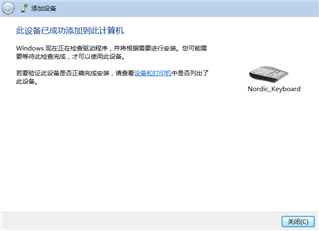

        I want to consult one question about "BLE HID Keyboard". I am trying  to use the product---nRF52832 to make the "BLE HID Keyboard".
        Then I download the source "nRF5_SDK_12.3.0_d7731ad" from Nordic official website, and compiled the example---"ble_app_hids_keyboard" in Keil 5 without any modification.
        nRF52832 run the program successfully, and it can connect to android device and their communication is successfully.
        when it broadcast to win7 computer, the computer can scan it and make a connection. But I can not find any services or function in the "Nordic_Keyboard" 's equipment properties.
        So when the "Nordic_Keyboard"  device sends a report, win7 computer has no response.
        (left picture means Nordic_Keyboard was add to computer)     (right picture means computer can not find any BLE service in Nordic Keyboard)
      By the way, I buy a BLE4.0 Keyboard online and compare it with nRF52832 Nordic_Keyboard.  The test shows that BLE4.0 Keyboard can work well in win7 computer.
      So I want to know how to modify the code in "nRF5_SDK_12.3.0_d7731ad" to help nRF52832 Nordic_Keyboard work successfully in win7 ?

  • As you know windows 7 does not have native support for BLE, so it is entirely up to the vendor of the ble solution you are running on your windows machine to provide this functionality. I am afraid there is not much we can do if the CSR dongle you are testing with doesn't have proper HID support. Unfortunately, the log you provided did not help as the traffic was not decrypted. I assume MITM protection is on, which means the sniffer cannot decrypt.
