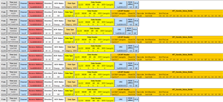

  • thanks for your response, i disabled the encryption to see the packets in the cc2540 based sniffer, see the below screen shot:
    as you can see in the above picture the slave(nrf51822 as peripheral) try to send some thing on the notification char, but the master(cc2540 as central) did not ack the packets and this loop continue for 9sec (configured supervision timeout) and after that both central and peripheral report a disconnection event. the reason could not be signal power and crc check problem because after that disconnection happen peripheral start to advertise and then tow device reconnect to each other.
    i do not have any idea about this disconnection reason, may be it was because timing problem. can you give me a advice to solve this timeout problem??
    i also attached the ble dump between central and peripheral(you can open it with ti sniffer app)Decrypted_1.psd

    Kenneth is on vacation so I will take over the case. From your trace, it looked like the central (CC2540) didn't receive the packets from the peripheral after the ATT_ERROR_RESPONSE. I suspect there could be an assert on the central, causing the stack to crash or unable to process more packet, as it kept sending pacets with NESN = 0 , SN = 0 until a timeout.
    You may need to check the TI chip's code, maybe do some debug or get some more logging from the device.
