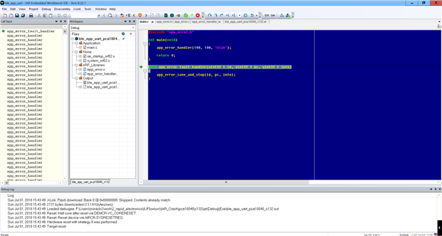

I am experiencing problems with the app_error_handler function defined in app_error_handler_iar_c provided with the SDK V15.0.0.
If the function gets called when debugging with IAR, the IAR IDE will hang for ~15 seconds (or even crash), before reappearing in app_error_fault_handler.
Looking at the stack trace, it appears as through app_error_handler has repeatably called itself, before (presumably) running out of stack.
Is anybody else experiencing this problem? Is this a known issue?

The extract from the stack trace provided by IAR:
-------------------------------->8--------------------------------------------------------
app_error_handler
app_error_handler
app_error_handler
... {30 more}
app_error_handler
app_error_handler
app_error_handler
app_error_handler
app_error_handler
app_error_handler

    I have the same issue, using IAR 8.30.1.
    I also see the issue with the example blinky code, when DEBUG is defined.
    It seems like a bug in this SDK that the assembly code is breaking the stack. I am using app_error_handler() from the previous SDK.

  • Edvin,
    I just use code below, from previous SDK and this works fine. In callstack, while debugging, I still can see the cause of the assert. Also line nr and file name are correct.
    The assembly version of SDK 15.2.0 does not hang, but call stack is gone as can be seen in screenshot of. So while debugging you cannot easily trace back where the assert was by clicking in the callstack  (but it is in error_info_t struct).
    void app_error_handler(ret_code_t error_code, uint32_t line_num, const uint8_t * p_file_name)
