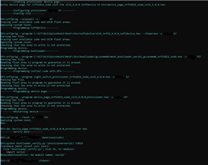

I'm adding key protection to DFU, a batch script is creating the bootloader_config_default.json. I'm using mesh SDK 2.0.1, but started developing using Mesh SDK 2.0.0. When I added public_key to my bootloader_config_default.json file device page generation fails. While testing with the device_page_generator.py from SDK 2.0.0 this was no issue. The only difference I can find are these:
#LINE 69 of device_page_generator.py
#From Mesh SDK 2.0.0
raise TypeError("Invalid type %r" % (type(data)))
#From Mesh SDK 2.0.1
raise TypeError
#Line 99
public_key = bytearray.fromhex(bootloader_config["public_key"]) \
public_key = bootloader_config["public_key"] \
As I am not very "fluent" in Python I'm not sure if I can use the device page generator from the Mesh SDK 2.0.0. so please advise.
The error I get is as follows:
SDKROOT\Mesh\tools\dfu>python device_page_generator.py -d nrf52832_xxAA -sd "s132_6.0.0"
File "device_page_generator.py", line 241, in <module>
main()
File "device_page_generator.py", line 235, in main
write_specific_page(platforms, softdevices, args)
File "device_page_generator.py", line 178, in write_specific_page
device_page = DevicePage(platform, softdevice, bootloader_config)
File "device_page_generator.py", line 94, in __init__
self.generate_entries(platform, softdevice, bootloader_config)
File "device_page_generator.py", line 103, in generate_entries
DevicePageEntry(BLInfoType.ECDSA_PUBLIC_KEY, public_key))
File "device_page_generator.py", line 69, in __init__
raise TypeError
TypeError
