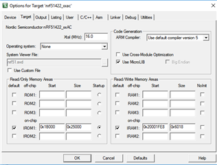

How to upload OTA again after successful first Buttonless OTA upload?
Hi, Everyone
My development environment is PCA10028, SoftDevice 130, SDK12.3.0
I downloaded the application using nRF5_SDK_12.3.0_d7731ad \ examples \ dfu \ bootloader_secure
A downloaded program works fine
I tried "Experimental: Buttonless DFU Template Application"
I download the application download using \nRF5_SDK_12.3.0_d7731ad \ examples \ ble_peripheral \ experimental_ble_app_buttonless_dfu
Downloaded as a testing procedure at the address below
(https://infocenter.nordicsemi.com/index.jsp?topic=%2Fcom.nordic.infocenter.sdk5.v12.0.0%2Fgroup__nrf__dfu__settings.html)
(DFUTARG -> Nordic_Buttonless -> application program works fine)
I will try to download a modified application program
How can i download ?
In nRF Toolbox i can not find 'Nordic_Buttonless'
Regards
Alex
  • Thank you for your kind advice.
    But I have not yet solved the buttonless dfu.
    According to your advice I merged the ble_app_nus with the buttonless_dfu application
    In the DfuTarg state, the program is normally downloaded.
    If I set #define TEST 0 in main.c, 'Buttonless dfu' appears in scan using nRFConnect.
    However, if I set #define TEST 1 in main.c and scan using nRFConnect, nothing is scanned.
    Other modifications can be found in softdevice_handler.c:
      p_ble_enable_params-> common_enable_params.vs_uuid_count = 2;     //orig 1
    I attach main.c and nrfLog.
    regards,

     * Copyright (c) 2014 - 2017, Nordic Semiconductor ASA

  • Hi Alex,
    Sorry for the delayed response. I ran your example & started a uart log, where I saw this message at the top:
    SDH:DEBUG:sd_ble_enable: RAM start at 0x20001ff8
    SDH:WARNING:sd_ble_enable: RAM start should be adjusted to 0x20001fe8
    SDH:WARNING:RAM size should be adjusted to 0x6018
    As soon as I changed the IRAM1 Start & Size, the device advertised like it should:
    This custom service tutorial summarizes why the RAM needs to be increased: "Now, adding a vendor-specific UUID to the BLE stack results in the RAM requirement of the SoftDevice increasing, which we need to take into account."
    Hope that helps! Have a nice day!
  • Hi, Bjorn
    I was late to develop a product based on multilink for a month
    I changed the address according to your advice and the device search is done.
    However, device names and services appear as unknown.
    I have attached the file. The used program used a previously uploaded zip file.
    nrfutil pkg generate --hw-version 51 --sd-req 0x87 --application-version 0 --application app.hex --key-file private.key app_dfu_package.zip
    In the DfuTarg state, the program is normally downloaded dfu_package.zip.
    I do not know what's wrong.
